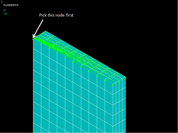

First, a coupling constraint is applied to the nodes on the top of the coupon. This allows for a simple determination of the total reaction force during post-processing.
  1. Select Preprocessor > Coupling / Ceqn > Cupl DOFs w/Mstr.
  2. Pick all nodes on the top surface of the coupon, making sure that the first node picked is the node indicated in the image below. Click OK.
  3. Set the reference number to 100 and the degree-of-freedom label to UY. Click OK to complete the coupling definition.
    As a consequence of the coupling constraint, a displacement in the y-direction applied to the node highlighted below results in the same y-displacement applied to the remaining nodes in the constraint definition.
