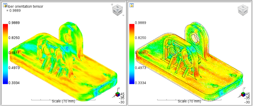

Now we are ready to map results to the structural model. The pedal base does not contain weld surfaces, so we don't need to calculate strength reduction factors.
  1. Click (Home > Mapping > Map Results).
  2. Rotate the model as necessary to examine the mapped results.
