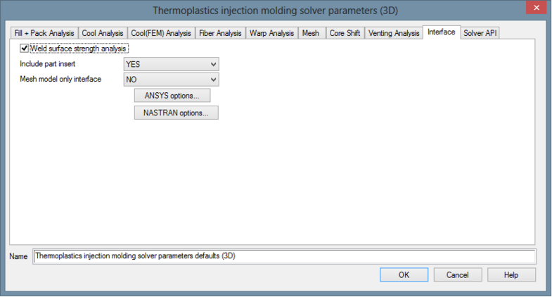

Activate Weld Surface Strength Analysis
We need to activate the weld surface strength analysis to obtain the temperature and pressure histories. This must be done before running the Moldflow simulation.
  1. Click Process Settings
  2. Click Advanced Options
  3. Click Edit in the Solver Parameters frame
  4. Select the Interface tab
  5. Turn ON the Weld surface strength analysis option
  6. Click OK
When the Weld surface strength analysis option is activated, Moldflow will create a .ws3 file during the analysis. This .ws3 file is read by Advanced Material Exchange when the study file is imported.
