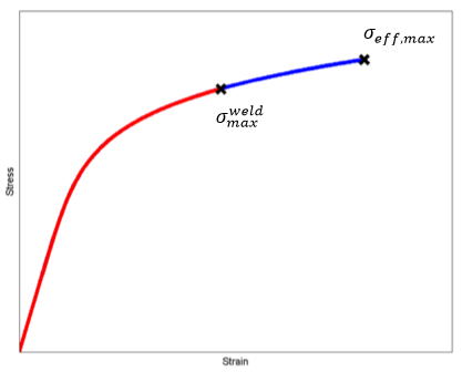

The strength reduction factor, whether calculated automatically or user-specified, is applied as a simple multiplier to scale the strength of the material. In particular, we scale the maximum effective stress, σeff,max, of the material.
Where η is the strength reduction factor and must lie in the range 0 < η ≤ 1. This scaling of the maximum effective stress causes the material that lies on the weld surface to fail sooner than the same material that is not on the weld surface.
