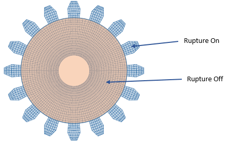

Let's look at an example use case. In this example we want to turn off rupture for the regions of the gear model where we don't expect failure. Let's assume that experimental test results have shown us that failure only occurs in the teeth of the gear, not in the base. Since we are only expecting failure to occur in the teeth, we can turn off rupture for the rest of the model. This has the potential to reduce the runtime for this analysis.
Even though the same plastic material is used throughout the gear, we must setup the structural input file as though two materials are used -- one for the teeth, one for the base.

Note: The only difference between these two definitions is the name. The original material (CA-MATERIAL) is applied to an element set encompassing the gear teeth. The material without rupture (CA-MATERIAL-NORUPTURE) is applied to an element set encompassing the gear base.

Note: The only difference between these two definitions is the material ID. The original material (10751) is applied to a region encompassing the gear teeth. The material without rupture (20000) is applied to a region encompassing the gear base.
