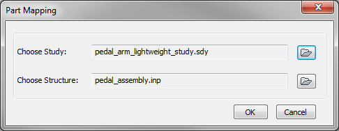

  1. Click (Start & Learn > Information Pairing > Part Mapping).
  2. When the Part Mapping dialog appears, select the study file to be paired. Once selected, you will see a preview of your model that you can use to verify the correct model was selected. If it is the correct model, click OK.

  1. Click Home > Information Pairing > Part Mapping.
  2. When the Part Mapping dialog appears, select the new study file to be paired. The structural assembly selected during the first pairing is remembered so you don't need to specify the file again.
