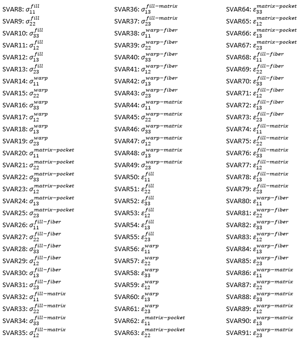

Woven Composites - Static Analyses
For
woven composite materials, state variables SVAR2, SVAR3, ..., SVAR90 have the following interpretations for static progressive failure analyses:
- SVAR2
- SVAR2 is a continuous real variable ranging from 0.0 to 1.0, indicating the fraction of the matrix failure criterion that has been satisfied for the matrix constituent within the fill tows.
- SVAR3
- SVAR3 is a continuous real variable ranging from 0.0 to 1.0, indicating the fraction of the fiber failure criterion that has been satisfied for the fiber constituent within the fill tows.
- SVAR4
- SVAR4 is a continuous real variable ranging from 0.0 to 1.0, indicating the fraction of the matrix failure criterion that has been satisfied for the matrix constituent within the warp tows.
- SVAR5
- SVAR5 is a continuous real variable ranging from 0.0 to 1.0, indicating the fraction of the fiber failure criterion that has been satisfied for the fiber constituent within the warp tows.
- SVAR6
- Unused
- SVAR7
- SVAR7 is the second term in the MCT matrix failure criterion for woven composites and is used in the pre-failure nonlinearity feature. SVAR7 is unused if pre-failure nonlinearity is turned off.
For the case of woven composites, the remaining MCT state variables store the individual components of the average stress and strain states in the various superconstituents and constituents (e.g., fill = fill tow superconstituent, warp = warp tow superconstituent, matrix-pocket = matrix constituent of the intertow matrix pockets, fill-matrix = the matrix constituent of the fill tow, warp-matrix = the matrix constituent of the warp tow, fill-fiber = the fiber constituent of the fill tow, warp-fiber = the fiber constituent of the warp tow).
