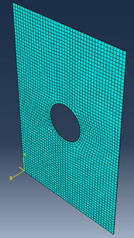

Create the mesh for the composite plate.
In meshing the composite plate, an approximate seed size of 0.006 is used to ensure the mesh is fine enough to capture the location of failure, but also coarse enough for a short solution time.
or select from the main toolbar. The Global Seeds dialog box appears.
or select from the main toolbar. The Element Type dialog box appears.
or by selecting from the main toolbar. Click the Yes button. The mesh should be similar to the mesh shown below.
