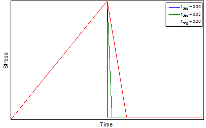

In Abaqus/Explicit analyses which use instantaneous degradation, degrading the material properties instantly can have adverse effects on the response of the structure. Local material responses with large rates of change in stiffness can generate shockwaves in the material that prematurely initiate damage in adjacent elements. To mitigate this effect, we specify a time period over which to degrade material properties via user material constant 11. This value must be greater than or equal to zero. Larger time periods will result in smaller rates of change in stiffness.
When a failure is initiated the material properties are not automatically reduced to the next material state. The material stiffness is updated based on the following equation:
where
and
are the material stiffnesses at the next material state and previous state respectively, and
is the updated (intermediate) material stiffness.
is defined as:
where ti, tf, and tdeg, are the current time, time at failure initiation, and the degradation time period (user material constant 11) respectively. The image below depicts the local material response as a function of time for different values of the time degradation period (constant strain after failure initiation).

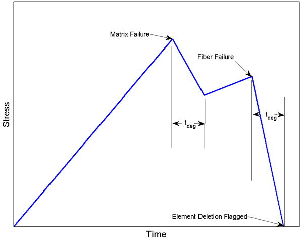

See the plot below for an idealized example of the stress at an integration point with respect to time.
