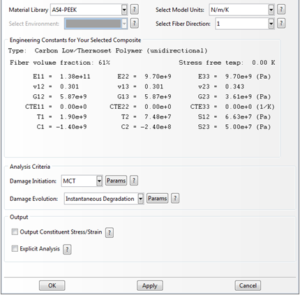

Follow the steps below to assign the AS4-PEEK material to part Composite_Plate.
2 can also be used as the fiber direction, but it would require a different composite layup orientation than the 1 direction. As a general rule, it is recommended that 1 be used as the fiber direction to maintain consistency from model to model. On occasion, however, it will not be possible to create an orientation in Abaqus that allows for the 1 direction to be the fiber direction due to the combination of complex model geometry and section orientation limitations. In such cases, it may be necessary to use the 2 direction as the fiber direction.
After completing steps 1-7, a user material is created in the Materials container
in the Material Tree. This material is used to define the composite layup for the plate.
