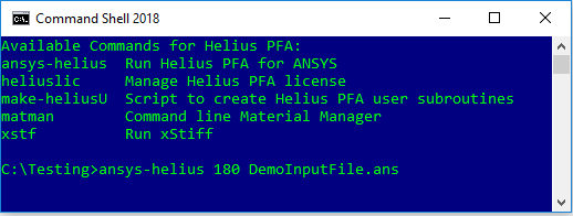

Helius PFA installs a Windows batch file, which makes it simple to run ANSYS with Helius PFA using an ANSYS input file from the command line.
This file is located at HPFADIR\bin\ansys-helius.bat and can be modified using a text editor to meet your specific needs. To run this file, follow these steps (see the image below) :
ansys-helius VERSION FILE
where VERSION is one of 180, 181, 182, or 190 depending on the target ANSYS version and FILE is the name of the input file saved in step 1.
