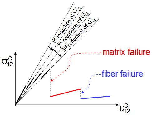

To set the stage for describing the implementation of the pre-failure nonlinearity feature, refer to Part A of the plot in the Damage States in Unidirectional Composite Materials section. Focus on the initial linear elastic region (labeled Damage State 1) that occurs prior to any matrix or fiber constituent failure. As stated earlier, a linear elastic response prior to matrix failure is reasonable for normal stresses. However, the longitudinal shear stiffness of a composite material should exhibit a significant amount of softening prior to matrix failure.
Within the region labeled Damage State 1 in Part A of the plot mentioned above, the
Helius PFA pre-failure nonlinearity feature employs a
four-segment, piecewise linear representation of the longitudinal shear response (i.e.,
vs.
and
vs.
). The original linear elastic response for the remaining four stress and strain components is maintained. The plot below provides a qualitative illustration of the composite average longitudinal shear response (
vs.
and
vs.
) that occurs when the
Helius PFA pre-failure nonlinearity feature is invoked for unidirectional composites. In this plot, prior to any matrix or fiber constituent failure, the composite average longitudinal shear moduli (
and
) undergo a series of three discrete reductions. The discrete reductions in
and
are produced entirely by consistent discrete reductions in the matrix average longitudinal shear moduli
and
while all other matrix and fiber constituent properties remain constant. This procedure is intended to simulate the gradual accumulation of sub-microcracks in the matrix that occurs prior to complete matrix shear failure.

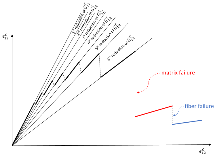

seven-segment, piecewise linear representation of the longitudinal shear response (i.e.,
vs.
and
vs.
vs.
and
vs.
Helius PFA pre-failure nonlinearity feature is invoked for woven composites. In this plot, prior to any matrix or fiber constituent failure, the composite average longitudinal shear moduli (
and
) undergo a series of six discrete reductions. The discrete reductions in
and
and
