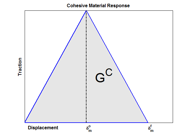

For the energy based damage evolution criterion, user material constant eight is interpreted as the total fracture energy of the cohesive material, GC. The image below shows how GC relates to the traction-separation response of the cohesive material. The value of GC you supply is used to determine the final relative effective displacement as:
where
is the effective traction at damage initiation.
