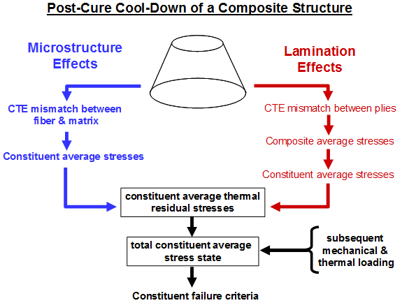

At room temperature T=Tamb, the fiber and matrix constituents of an isolated, unloaded, unconstrained, unidirectional composite ply already have a nonzero stress state. This is due to post-cure cooling of the composite material from the cure temperature T=Tcure to ambient temperature T=Tamb. In an isolated composite ply, these thermal residual stresses are caused solely by differences in the coefficients of thermal expansion of the matrix and fiber constituents. Typically, during post-cure cooling of a fiber-reinforced composite ply, the matrix constituent attempts to shrink more than the fiber constituent. Thus, the matrix constituent exhibits tensile thermal residual stresses and the fiber constituent exhibits compressive thermal residual stresses. However, the composite average stress state is zero. These constituent thermal residual stresses contribute to the total constituent stress states during any subsequent thermomechanical loading of the composite ply and thus influence the load at which constituent failure occurs.
When a composite ply is embedded in a laminate that undergoes a post-cure cool down, additional thermal residual stresses are induced in the composite ply. This is due to differences in thermal coefficients of expansion between the ply in question and its neighboring plies. Unlike the case of an isolated composite ply, this type of inter-ply action causes the composite average stress state at the ply level to be non-zero, i.e., the ply develops composite average thermal residual stresses. These stresses can be decomposed into fiber and matrix average thermal residual stresses which contribute to the total fiber and matrix average stress states during subsequent thermomechanical loading. Thus, the stresses influence the loads at which constituent failure occurs.
These two sources of thermal residual stresses at the constituent material level are shown schematically below. It is shown that constituent thermal residual stresses add to the constituent stresses produced by the normal externally applied mechanical and thermal loading of the structure.

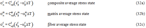

Equations 32a-c list the linearized, thermomechanical constitutive relations (secant formulation) for a unidirectional composite material, the matrix constituent material and the fiber constituent material.
In Eq. 32a, the total composite strain state at a point (
) is provided directly by the structural finite code, whereas in Eqs. 32b and 32c, the total constituent strain states at a point (
and
) are determined using the MCT decomposition of
. For temperature-dependent composite materials, both the stiffnesses (
) and the coefficients of thermal expansion (
) are dependent on the current temperature T and the current failure state of the fiber and matrix constituent materials. For temperature-independent composite materials, both the stiffnesses (
) and coefficients of thermal expansion (
) are dependent only on the current failure state of the fiber and matrix constituent materials.

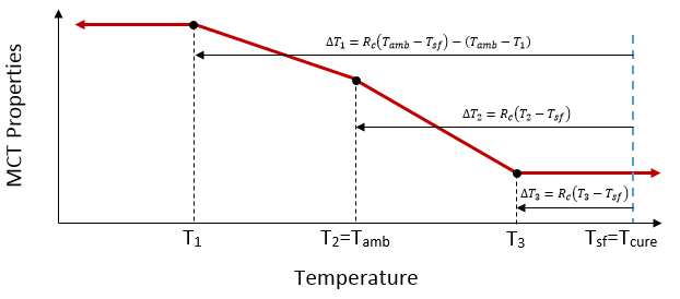

When the thermal residual stress calculation feature is turned 'ON', there are two methods for calculating the temperature change used in Eqs. 32, depending on whether or not the material properties for the current temperature are used (default), or if a unique set of material properties are specified.
For the default case in which the current properties are used, the temperature change is computed as follows:
In Eq. 33a, Tamb is the ambient temperature which is understood to be 72.5 °F, 22.5 °C or 295.65 °K depending upon the system of units used in the model. T is the current temperature, and Tsf is the stress free temperature.
When the current temperature T > Tamb, Eq. 33a ensures that thermal residual stresses are correctly predicted at the end of the post-cure cool down. The quantity Rc denotes the cure ratio. By default, Rc is set to a value of 0.5. This default value is based on the work of Kenik [13]. Kenik showed that a simple linear elastic analysis using room-temperature composite material properties with an imposed temperature reduction of one-half the actual post-cure cool down, produces constituent thermal residual stresses approximately equal to those predicted by a more rigorous micromechanical simulation of the post-cure cool down using temperature dependent matrix properties. To adjust the value of Rc, refer to the Thermal Residual Stresses topic in the respective Abaqus or ANSYS User's Guide.
When the current temperature T < Tamb, Eq. 33a ensures that any additional temperature reduction imposed after the post-cure cool down will produce the correct thermal stresses. In this case (T < Tamb), the total temperature change ΔT used by Helius PFA in Eqs. 32 includes 50% (with default value of Rc) of the temperature change from the stress free temperature Tsf to ambient temperature Tamb. It also includes 100% of the additional temperature reduction from ambient temperature Tamb to the current temperature T. However, if the current temperature T is at or above ambient temperature Tamb, the total temperature change ΔT used by Helius PFA in Eqs. 32 accounts for only 50% (with default value of Rc) of the actual temperature change from the stress free temperature Tsf to the current temperature T. Note, this method of computing ΔT ensures thermal residual stresses vanish if the material is re-heated to the cure temperature Tcure.
Notice that when T = Tamb, Eq. 33a reduces to the same equation.

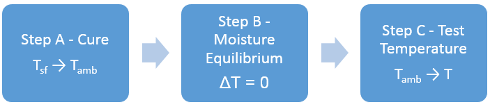

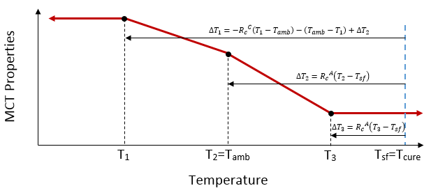

For the case where a unique set of material properties are used in the calculations at ambient temperature, the temperature change is computed in two steps. First, for the change from cure temperature to ambient temperature (Step A), and second, from the ambient temperature to the current temperature (Step C). (Step B, involves a change in moisture from the cure environment to the ambient environment.)
For Step A, the material properties at the ambient moisture and temperature are used. For Step C, the material properties for the current moisture and temperature are used.
In Eq. 33b, { } are Macaulay brackets where {x}=0 for x<0, and {x}=x for x ≥ 0. Tamb is the ambient temperature specified in the *CURE STRESS keyword in the HIN file. If the temperature is not specified, Tamb is understood to be 72.5 °F, 22.5 °C or 295.65 °K depending upon the system of units used in the model. T is the temperature at which the test is performed (current temperature).
The right-hand side of Eq. 33b ensures that thermal residual stresses are correctly predicted at the end of the post-cure cool down to ambient temperature (i.e., when T=Tamb). The quantity RcA denotes the cure ratio for this step. By default, RcA is set to a value of 0.5. This default value is based on the work of Kenik [13]. Kenik showed that a simple linear elastic analysis using room-temperature composite material properties with an imposed temperature reduction of one-half the actual post-cure cool down, produces constituent thermal residual stresses approximately equal to those predicted by a more rigorous micromechanical simulation of the post-cure cool down using temperature dependent matrix properties. To adjust the value of RcA, refer to the Thermal Residual Stresses topic in the respective Abaqus or ANSYS User's Guide.
The right-hand side of Eq. 33c ensures that any additional temperature reduction imposed after the post-cure cool down will produce the correct thermal stresses. Note that the use of the Macaulay brackets { } ensures the first term on the right-hand side of Eq. 33c contributes to ΔT only if the current temperature T is above the ambient temperature Tamb. The quantity RcC denotes the cure ratio for this step. By default, RcC is set to a value of 0.5. To adjust the value of RcC, refer to the Thermal Residual Stresses topic in the respective Abaqus or ANSYS User's Guide. If the current temperature T is below the ambient temperature Tamb, no cure ratio is applied.
The total temperature change ΔT = ΔTA + ΔTC.
Eqs. 32 and 33 are also used during the MCT material characterization process for composite materials characterized at multiple temperatures. The image below illustrates a typical case where a temperature-dependent composite material has been characterized at three distinct temperatures T1, T2, and T3, where T1<Tamb, T2=Tamb and Tamb<T3<Tcure. It also shows the temperature change ΔT (computed via Eqs. 33a-c) that is included in the micromechanical analysis of the composite material at each of the three temperatures during the MCT characterization process. During the characterization process, these imposed temperature changes influence the determination of the constituent failure coefficients. For example, when the micromechanical model is mechanically loaded to a measured failure load level, the failure stress state in the constituent materials have contributions from both the mechanical loading and the imposed temperature change.
