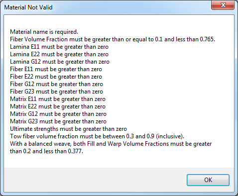

When is selected, a check is performed to ensure that the required data has been entered and is within appropriate limits. If data is entered incorrectly, an error message will result. An example error message is shown below.
