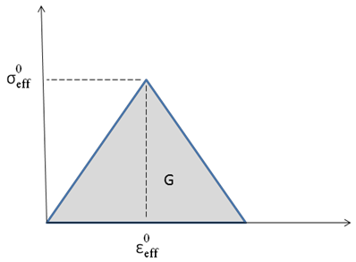

To use the energy-based degradation (EBD) feature in Helius PFA, two values are required:
The EBD feature in Helius PFA uses a linear degradation model as depicted below.
From the image above, the total energy of an element can be expressed as
where
is the value of the composite effective strain at matrix/fiber failure,
is the effective stress of the composite at matrix/fiber failure, and Ve is the volume of the element.
