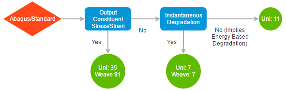

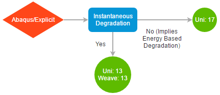

The solution-dependent MCT state variables (SDVs) track constitutive quantities of interest at each integration point in the finite element model. The number of solution dependent state variables present in a model is dependent on several factors and is specified by the *DEPVAR keyword. Use the flow chart below to determine this number. The default naming convention for the solution-dependent MCT state variables is SDVi, where i=1, 2, 3, …, 7, 11, 13, 17, 35, or 91. The most useful of the MCT state variables is SDV1 which tracks the discrete failure state of the composite material at each integration point in the finite element model. The exact interpretation of the discrete values of SDV1 will depend upon the specific set of Helius PFA material nonlinearity features used in the analysis. Appendix C provides a complete description of each MCT state variable, including tables that define the interpretation of the discrete values of SDV1 for various combinations of material type and material nonlinearity features invoked.
