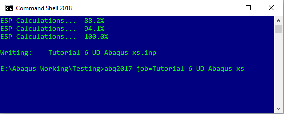

Now we are ready to run the analysis.
  1. Make sure the Tutorial_6_UD_Abaqus_xs.inp and Tutorial_6_UD_Abaqus_xs.hin files are saved in your working directory.
  2. Return to the Command Shell and type the following to submit the analysis, in this case with Abaqus 2017.
    >>abq62017 job=Tutorial_6_UD_Abaqus_xs
Note: If you decided to create the model using the matrix element deletion criteria suggested in the previous step, you may also run those models at this time.
