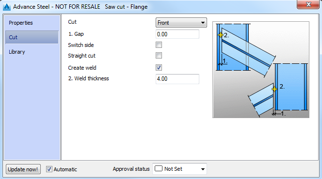

Cut |
Select the side of the main beam Front - on the front side of the main beam Rear - on the back side of the main beam |
Gap |
Defines the construction gab between the beams. |
Switch side |
Straight cut |
Cuts the beam vertically. Otherwise, the second beam is cut parallel to the first beam. |
Create weld |
Creates a weld between the two beams. |
2. Weld thickness |
Defines the weld thickness. |

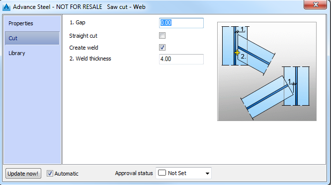

On this tab of the properties dialog box, you can set the clearance between the beams.
Gap |
Bisecting line |
When selected, the intersection of the beams is created at the bisecting line. |
Create weld |
2. Weld thickness |
