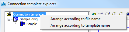

The Connection Template Explorer
Displays a list of all defined custom connections available in ProgramData\Autodesk\Advance Steel 2019\[INSTALLATION LANGUAGE EXTENSION]\Shared\ConnectionTemplates.
Using the Connection Template Explorer you can:
The Connection Template Explorer includes sorting options that allow you to easily find a connection.
