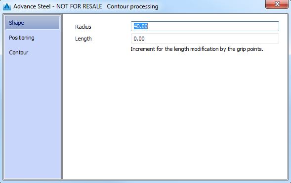

Circular Contour Processing Dialog: Shape Tab
Use the parameters on this tab to modify the circular contour size.
Radius
Defines the radius of the circular processing (green contour).
Length
Defines the length increment (grid jump) when modifying the length using the grips.
