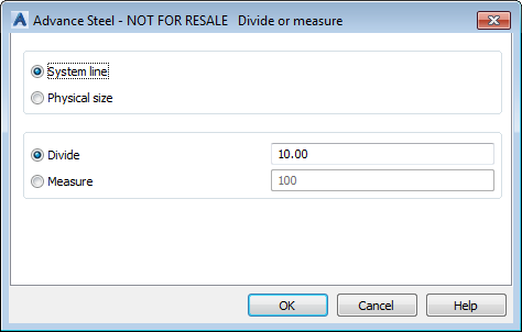

The Divide or Measure Dialog Box
In this dialog box you can configure the options for creating snap points on a beam.
Command access
Tools tool palette: (Divide or measure).
Command line: _AstM9CommDivideOrMeasure
System line
The entire system line is divided. The shortening, extensions and other features are not taken into account.
Physical size
Only the physical beam is divided. The existing features are taken into account.
Divide
Divides the beam in a defined number of segments.
Measure
Divides the beam in segments of a defined length.
