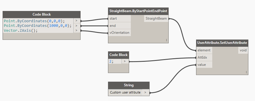

UserAttribute and select SetUserAttribute. The UserAttribute.SetUserAttribute node appears in the workspace. This node applies to both beams and plates.

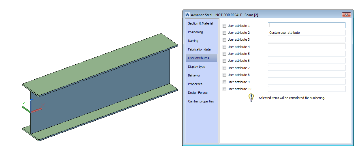

A simple workflow of using the UserAttribute.SetUserAttribute node is represented in the picture below. The result is an Advance Steel beam that has the value of the user attribute as defined by the string from Dynamo:
Having custom user attributes, you can apply filters in Advance Steel to select and modify the elements:
