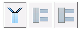

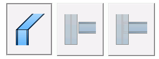

Model a Custom Connection
A custom connection is a custom combination of several basic elements drawn separately or as bricks, used to connect one, two or three profiles.
To create the custom connection template, you must model the elements to be connected by the joint and the elements that will be created by the joint. You can use any of the modelling methods available in Advance Steel:
Best practices
While modelling the custom connection, ensure you use good modeling practices such as:
Note: The sample connection must be modeled in a separate file.
