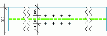

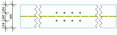

Arrange the dimension line above and not below
This option defines whether the dimension chain is placed above or below a detail view. In the vertical detail views above is left and below is right.
Option Example
Abbreviation: T (Top)
Abbreviation: B (Bottom)
