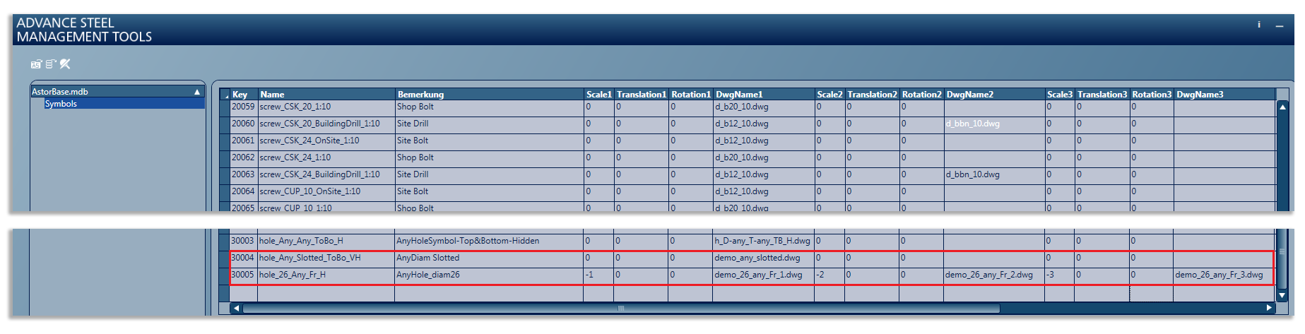

In order to start configuring a hole symbol, you need to access the AstorBase database Symbols table. To do this:
  1. Open the Management Tools application, from the Home tab Settings panel (Management Tools).
  2. In the Management Tools application, access the Table editor.
  3. In the top left corner of the Table editor, click on the second icon to open a database.
  4. The Open dialog appears. Choose the AstorBase.mdf database file and click Open.
  5. Once the AstorBase.mdf is loaded, expand the heading (by clicking on the arrow next to the database name) and navigate to the Symbols table - alternatively, you can type the word "Symbols" in the Use filter search field to access the table more easily.
  6. In the Symbols table, go to the last filled row and configure a new one after it.

Examples:
hole_Any_Slotted_ToBo_VH - all diameters for slotted holes, with a top / bottom view direction and a VisibleHidden visibility status.
hole_26_Any_Fr_H - any type of hole with the diameter equal to 26, viewed from the front and with a Hidden visibility status.

This is how the two example hole symbol configuration lines appear in the Symbols table:
