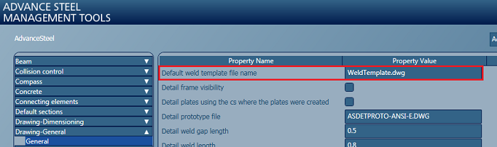

  1. Open the Management Tools application and check the default where the weld symbol template DWG name is specified.
    Open (Management Tools) Defaults category Drawing-General General Default weld template file name:
    Note: In this case, the weld symbol template file is WeldTemplate.dwg. This file may differ from one installation to another (e.g. different languages).

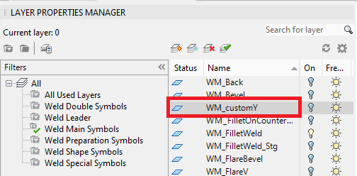

  3. Open the Layer Manager and create a new layer.
  4. First, create the weld main symbol for the new "Y" weld type. The new layer name should contain the "WM_" prefix followed by the desired name (for example, "WM_customY").

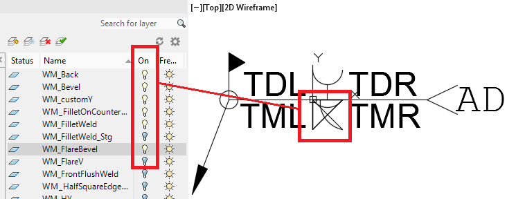

  5. Turn off all the other layers that are associated with weld main symbols, to avoid overlapping of symbols.

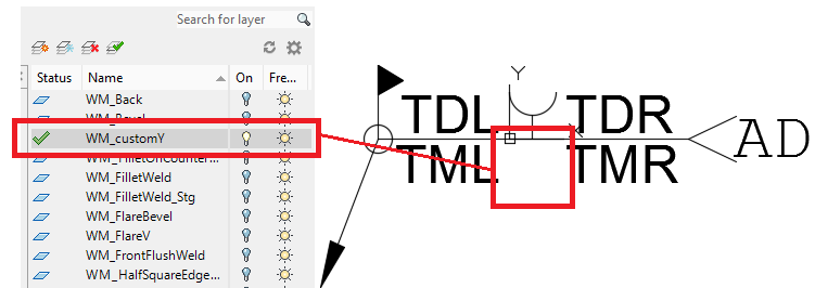

  6. Turn on the new layer (WM_cutomY) and set it as the current layer.
  7. Draw the desired symbol (be sure to draw on the correct layer).

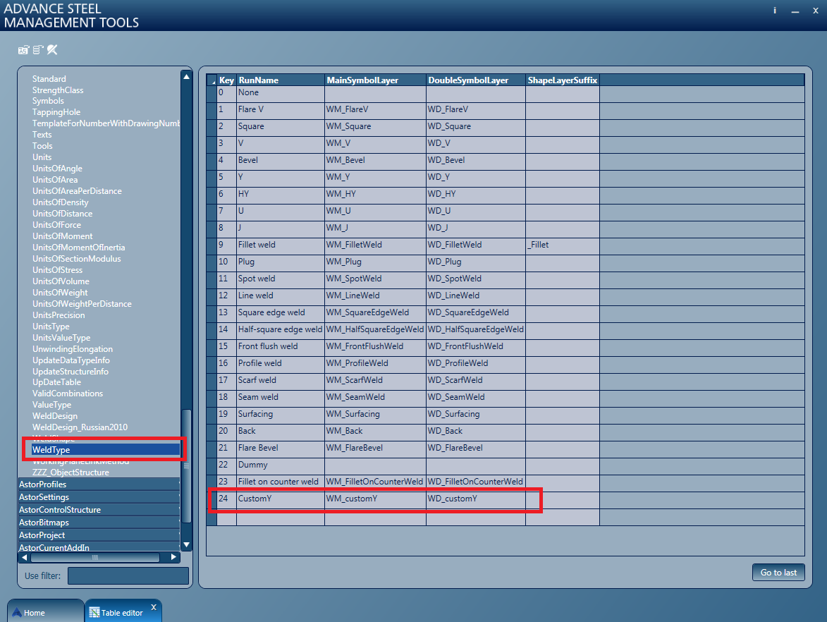

  11. In Management Tools, start the Table editor.
  12. Click the Open ODBC icon and select AstorBase.
  13. Open the WeldType table.

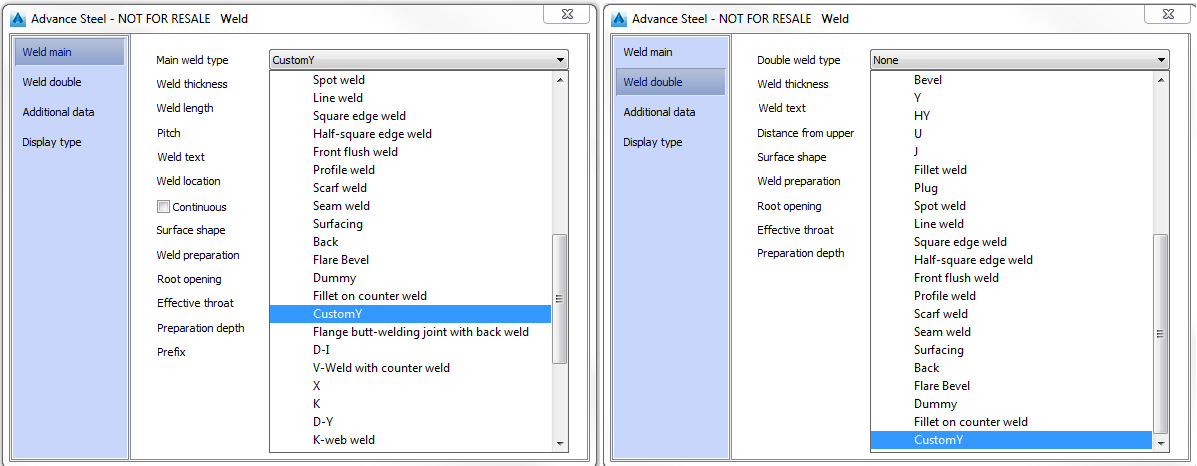

  14. Fill in the description for the new weld on the last free line:
    • Key = next available number.
    • MainSymbolLayer=The name for main weld symbol layer from "WeldTemplate.dwg", for example, WM_customY.
    • DoubleSymbolLayer=The name for double weld symbol layer from "WeldTemplate.dwg", for example, WD_customY.
    • ShapeLayerSuffix= Leave empty if the new symbol doesn't require a special shape symbol, if it does. see How is a surface shape symbol exception for welds created in Advance Steel.
