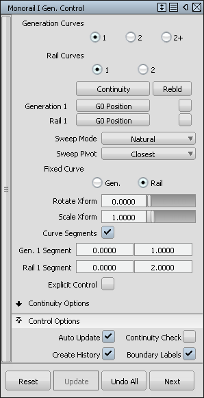

The procedure for using the Rail Surface tool has several optional steps, depending on the settings in the Rail Surface Control window.
- Choose Surfaces > Swept Surfaces > Rail Surface
from the tool palette, or double-click its icon. The Rail Surface Control window appears.
- Make sure Create History is checked.
You almost always want construction history on. This allows you to change the settings after you sweep the curves.

- In the Rail Surface Control window, set Rail Curves to 2.
Set Generation Curves to the number of generation curves to use:
- Choose 1 to sweep one curve along the rails.
- Choose 2 to blend from one generation curve to another along the rails.
- Choose 2+ to blend a series of generation curves along the rails.

- In the Rail Surface Control window:
- Set Generation Curves to 1.
- Set Rail Curves to 1.
- Set the Sweep Pivot to Off Curve.
- Select Auto Update.

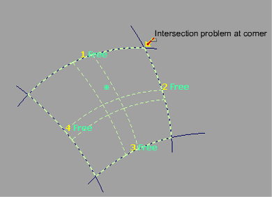

I can’t create a surface from my curves?
- Make sure your curves intersect. If modifications to the boundary curves cause them to stop intersecting (while construction history is on), a small red and yellow arrow appears at that corner. Right mouse clicking on the arrow displays a bubble with an explanation of the problem.
