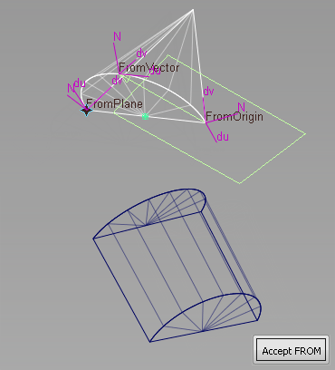

  3. Click to specify up to three points on the source object (or select existing points) or select an existing construction plane.
    After positioning the first point, a point locator is displayed. After positioning the second point, a vector between the two points is displayed. After positioning the third point, a plane is displayed.
    Note:
    If you click on an object, the point is constrained to that object. If more than one object are under the cursor, the pick chooser appears. Point to the hand icon next to the object you want. Keep the mouse button down to position the point.
    Tip:
    Use or snap to help position the points by attaching them to a CV, edit point, or curve. Use snap to snap a point to a grid intersection or detach an existing point (created through the use of the tool) from the geometry.
    Note:
    Picked construction planes are locked by default when you select them in the Transform > Place tool. To transform a picked construction plane, first click the Unlock Plane button.

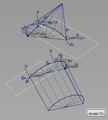

  4. Click the Accept FROM button.
  5. Click to specify three points on the target location (or select existing points) or select an existing construction plane.
  6. Click the Accept TO button.

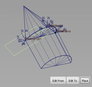

  7. Click the Place button in the lower right corner of the screen.
    The object is moved and rotated so that the planes defined by the two sets of points you selected in steps 3 and 5 coincide.
  8. Make any required modification to the point positions using the Edit From and Edit To buttons, then click the Place button to re-position.
