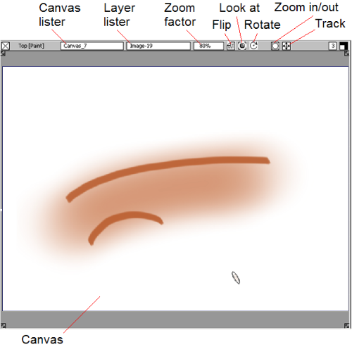

The title bar of the Paint window displays the name of the view window it is lying on, for example Top[Paint] or Persp[Paint].

You can create additional Paint windows by using Layouts > New Window and setting the Type option to Paint. Each Paint window can display any one of your canvases through the use of a lister in its title bar.
Click to show a menu from which you can select the canvas to be displayed in the Paint window.
Click to show a menu from which you can select a layer on the current canvas. This layer becomes the active layer (that is the one on which you’re painting). The active layer is indicated by a “*” in the lister.
Click to show a menu from which you can set a zoom factor. This has the effect of moving the canvas closer or further away from you.
The canvas first appears at a zoom factor such that it fills up the Paint window (best fit).
A zoom factor of 100% means one screen pixel is equal to one pixel on the canvas layer.
Use the Zoom in/out icon to zoom in or out in a continuous manner.
View the active canvas from behind. This icon behaves as a toggle. Only the active canvas in the Paint window is affected.
Re-center and re-orient the canvas in the Paint window so that it is back to the original view, that is the one that best fits the canvas to the window. Look at effectively resets any zooming, tracking or rotation applied to the canvas.
Rotate the canvas clockwise or counterclockwise around its center in the Paint window.
Move closer to the canvas for detail work, or move away from the canvas for an overall view.
Move up, down, left and right around the canvas.
