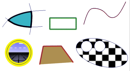

A shape is a way to create a precise image that you can easily modify. A shape’s shape is defined by a curve or set of curves. A shape also has fill and outline properties.
You can create a shape from any Alias curve, including curves-on-surface and surface edges. You can create shapes from curves by selecting Image(fill), Image(outline), Mask, or Invisibility mask from the pop-up menu in the Global Auto-Shape section of the Paint Panel. The shape is created as you draw the curve (as long as you have a canvas in the window where you are drawing).
After you create a shape from a curve or set of curves, any changes you make to the curves (for example, scaling a curve or moving an edit point) will update the shape.
