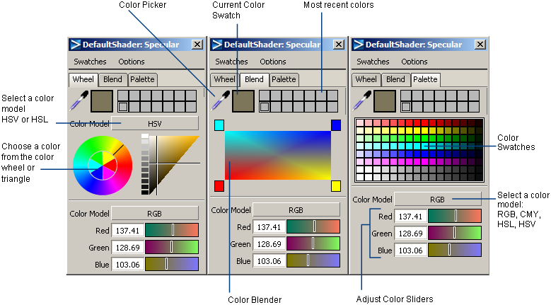

    • click the Brush Color in the Brush Options window to open the Color Editor.
    The color editor has three tabs.
  2. In the Color Editor, do any of the following to select a color:
    • Select a color model (HSL, HSV, CMY, or RGB) and adjust the sliders, or enter numerical values.
    • To adjust the color value only, set the color model to HSV and move the V slider.
    • Select a color model and click in the color wheel or triangle.
    • Click in the Color Blender. To change the colors in the Color Blender, set the current color (for example, using the RGB or HSV sliders) and then click a corner square in the Color Blender.
    • Click in the Color Swatches. To store the current color in the Color Swatches, drag the Current Color Swatch over a square on the Swatches board.
    • Click the Color Picker icon and click anywhere on your screen to grab that color.
    The Current Color Palette updates with the new color. The color chip in the status area also updates.

  1. In the Color Editor, do any of the following to select a color:
    • Pick a color model and adjust the sliders or type in numerical values.
    • Click in the color wheel or the color triangle.
    • Click in the Color Blending Palette.
    • Click in the Color Palette.
    The Current Color Swatch updates with the new color.
  2. Drag the Current Color Swatch from the Color Editor to the shelf with the .
