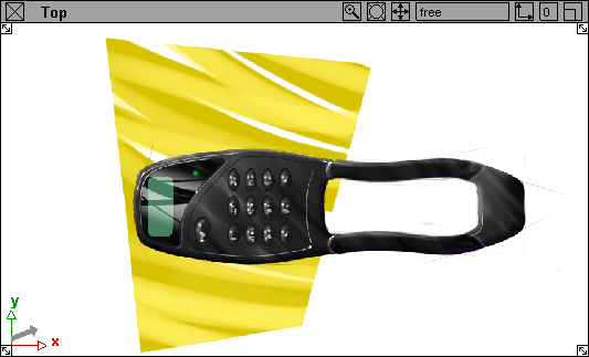

You create a canvas plane for a specific view (for example, the Top view). Each view (Top, Left and Back) can contain several canvas planes. If you select a brush and click in a view that does not contain a canvas plane, Alias automatically opens the New Canvas option box, prompting you to create a default canvas plane.
