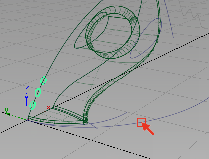

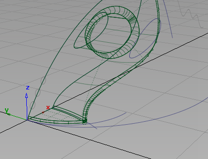

The surfaces are highlighted in pink, indicating that the surfaces have construction history. If you modify the curve, the surfaces updates. You are not modifying the curve; instead, take a copy so you can change the shape without affecting the surfaces.

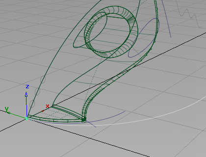

The surfaces are no longer highlighted in pink, as the new curve is a new copy with no relationship to the surfaces.
Use this scaled curve as a path curve for the extruded surfaces.

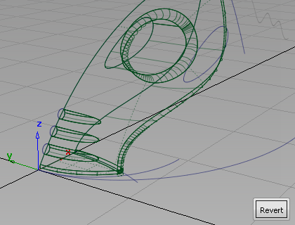

The three circles at the front of the vacuum cleaner have been templated so that you do not accidentally pick or modify them. Now untemplate these circles so you can use them as the generation curves for the extrude surfaces.

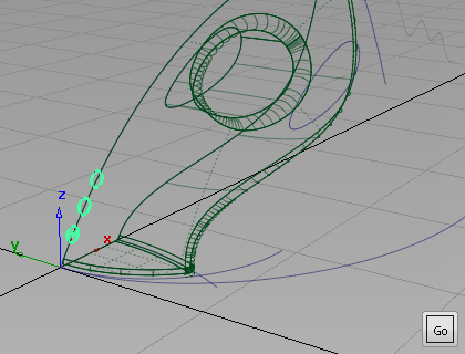

Now extrude the circles along the path curve.
Click Go to select the circles for extrusion.

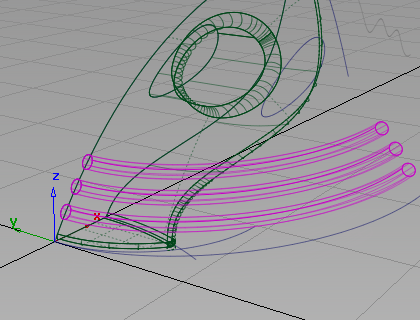

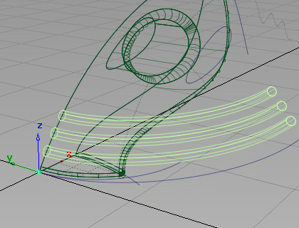

Three surfaces are created, following the shape of the upper surface.

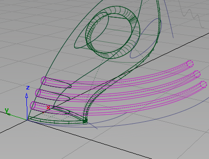

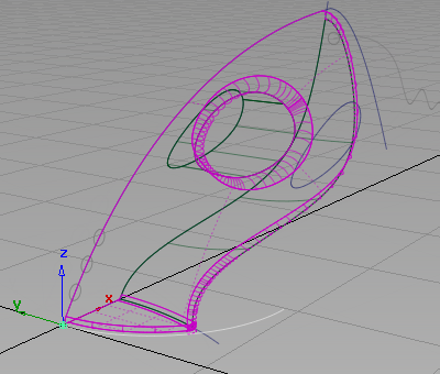

Now intersect and trim the three extruded surfaces with the upper surface of the vacuum body.
The three extruded surfaces are highlighted in pink, indicating they are selected for intersecting.
Pick the upper surface of the vacuum.
The surfaces are intersected and the curves-on-surface created.

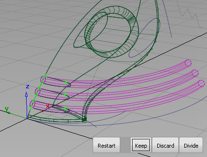

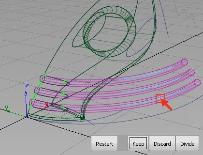

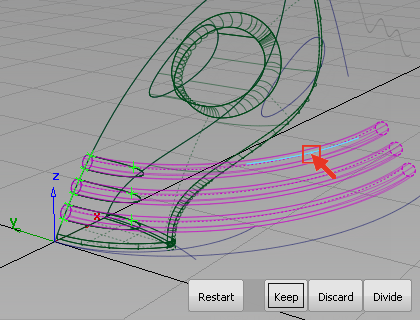

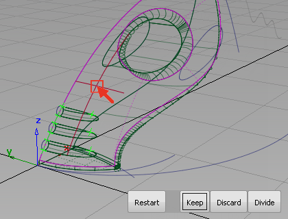

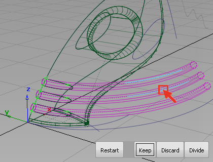

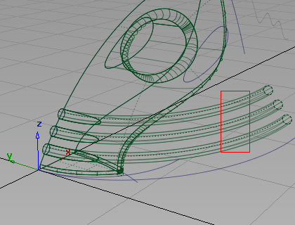

Now trim the excess from the surfaces, starting with the extruded surfaces. In this trimming operation, it is easier to select the part of the surfaces you want to discard, so use the Discard option in the trim tool, instead of the Keep option.
If you have many surfaces to trim, you can select them all using a pick box before choosing the trim tool.
The surfaces are highlighted in pink, and you are prompted to select the regions to trim.
The excess surfaces are discarded.

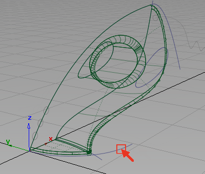

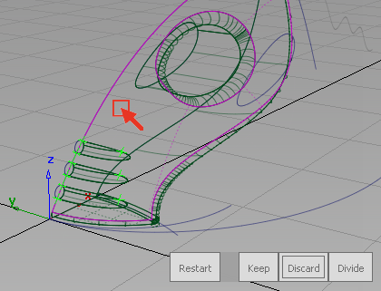

Next, you trim the upper surface.
An indicator is placed where you clicked and three buttons appear in the bottom right corner of the view.

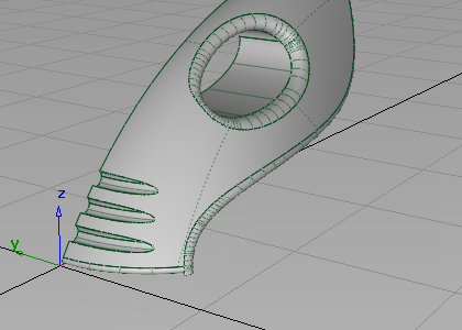

The upper surface is trimmed.

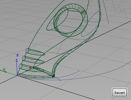

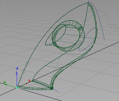

Now that you have created all the main surfaces, make the curves layer invisible, so the surfaces can be viewed more clearly.
On the Layer Bar, the curves layer displays with a dotted outline to indicate that it is turned off.
The curves are no longer displayed on the screen.
