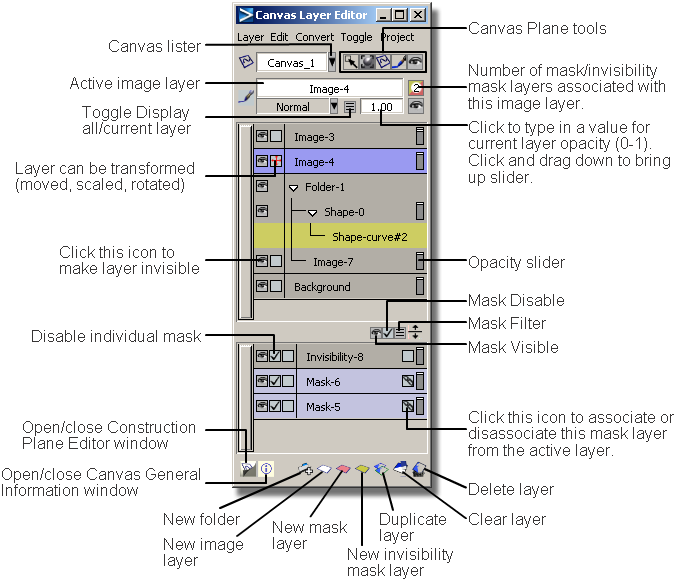

Windows > Editors > Canvas Layer Editor
Opens the Canvas Layer Editor window and allows you to control the arrangement of image layers, mask layers and shape layers on the current canvas.
Only the layers on the currently active canvas are displayed. Drag the mouse over an icon to see a “tool tip” describing its purpose.
The editor shows the different types of layers on the current canvas. Image layers and Mask layers are displayed separately inside a split window. This allows you to associate one or more mask layers with any image layer, and re-use the same mask layers for different image layers.
It is also possible to create Invisibility Mask layers in the bottom section of the window. These are similar to mask layers, except that the hidden paint can be shown again.
The layer thumbnails are turned on by default. To turn off the thumbnails (in order to provide more space for the layer names), choose Preferences > General Preferences , go to the Paint section, and remove the check mark in Show thumbnails in Canvas Layer Editor.
The window has a set of menus and icons for control over the layers. Some functionality can be accessed from either a menu item or an icon.
All the functions accessible through the menus can also be associated to a hotkey through the Special:Canvas Layer Editor section of the Hotkeys editor (Preferences > Interface > Hotkeys/Menus).

To change the active canvas
  1. Click the small arrow next to the canvas name in the Canvas Layer Editor.
  2. Choose another canvas from the Canvas Lister.
    The content of the Canvas Layer Editor updates to show the layers on the new active canvas.
To see the properties of the active canvas
  1. Click the icon at the bottom of the Canvas Layer Editor.
    The Canvas General Information window opens.
  2. Click the icon again to close it.
Canvas Layer Editor icons
Icon Meaning
Layer visibility in view window
Visible
Invisible
Active layer opacity value
Layer opacity slider
Display all layers
Display current (active) layer only
Layer type
Image (Paint)
Mask
Invisibility mask
Image (Paint) shape
Mask shape
Invisibility mask shape
Image layer has hidden paint
Text layer
Ability to move layer on canvas
Layer can be transformed
Layer cannot be transformed
Mask icons on divider bar (toggles)
Show/hide all masks linked with the active layer (but keep enabled)
Enable/disable all masks linked with the active layer
Show all masks/Show only masks linked with the active layer in lister
Link to imported canvas layers icon
Canvas layer is up-to-date with the imported image.
Canvas layer is out-of-date with the imported image. Click the icon to re-import the canvas layer.
Canvas Layer cannot be found. Click the icon and select Yes to re-import the canvas layers. Browse for the file and select it or unlink the imported image from the canvas layer.
Other mask icons
This mask layer is associated with the active layer
If the check mark is off, this mask layer is disabled but retains its link to any image layer
Number of mask layers associated with the active image layer.
Canvas Plane icons
See Construction Plane editor icons.
Tools (at bottom of editor)
Open/Close Construction Plane Editor
Open/Close Canvas General Information window.
New folder
New image layer
New mask layer
New invisibility mask layer
Duplicate layer
Clear layer
Delete layer
