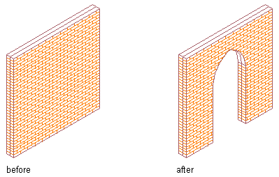

Use this procedure to place one or more openings in a wall.
Inserting an opening in a wall
Select a wall.
Click
Home tab
Build panel
Door drop-down
Opening
Specify the settings for the opening.
Specify an insertion point along the wall.
Continue to place openings in the wall, and press Enter.
