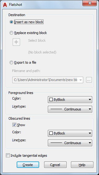

Flatshot Dialog Box
Creates a 2D representation of all 3D objects based on the current view.
FLATSHOT (Command) Find
The edges of all 3D solids and surfaces are projected line-of-sight onto a plane parallel to the viewing plane. The 2D representations of these edges are inserted as a block on the XY plane of the UCS. This block can be exploded for additional changes. The result can also be saved as a separate drawing file.
List of Options
The following options are displayed.
Destination
Controls where the flattened representation is created.
Insert As New Block
Specifies to insert the flattened representation as a block in the current drawing.
Replace Existing Block
Replaces an existing block in the drawing with the newly created block.
Select Block
Closes the dialog box temporarily while you select the block you are replacing in the drawing. When you finish selecting the block, press Enter to re-display the Flatshot dialog box.
Block Selected / No Block Selected
Indicates whether a block has been selected.
Export to a File
Saves the block to an external file.
Foreground Lines
Contains controls for setting the color and linetype of lines that are not obscured in the flattened view.
Color
Sets the color of lines that are not obscured in the flattened view.
Linetype
Sets the linetype of lines that are not obscured in the flattened view.
Obscured Lines
Controls whether lines that are obscured in the drawing are displayed in the flattened view, and sets the color and linetype of these obscured lines.
Show
Controls whether obscured lines are shown in the flattened representation. When selected, the 2D flattened representation displays lines hidden by other objects.
Color
Sets the color of lines that lie behind geometry in the flattened view.
Linetype
Sets the linetype of lines that lie behind geometry in the flattened view.
Include Tangential Lines
Creates silhouette edges for curved surfaces.
Create
Creates the flattened view.
