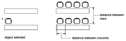

Creates an array of rows and columns of copies of the selected objects.
The selected object, or cornerstone element, is assumed to be in the lower-left corner, and generates the array up and to the right.
To add rows downward, specify a negative value for the distance between rows.
To specify the distance between rows and columns at the same time, specify two sets of coordinates or drawing locations that represent the opposite corners of a rectangle.
To add columns to the left, specify a negative value for the distance between columns.
