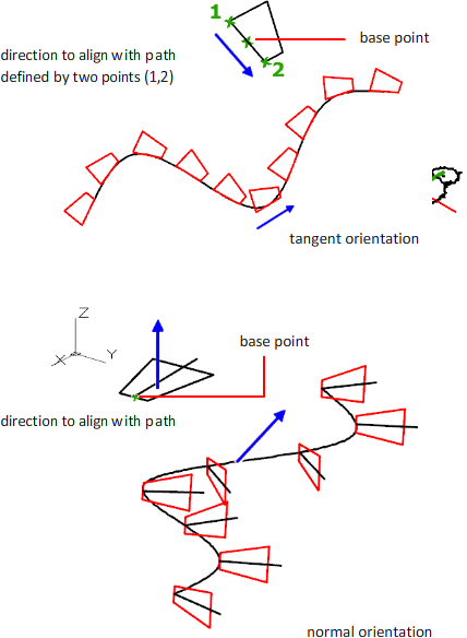

Defines the base point of the array. Items in path arrays are positioned relative to the base point.
Specifies a base point for positioning the items in the array relative to the start of the path curve.
For associative arrays, specifies a valid constraint (or key point) on the source objects to align with the path. If you edit the source objects or path of the resulting array, the base point of the array remains coincident with the key point of the source objects.

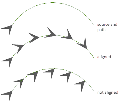

Specifies how the arrayed items are aligned relative to the starting direction of the path.

Specifies whether to align each item to be tangent to the path direction. Alignment is relative to the first item’s orientation.
Controls whether to maintain the items’ original Z direction or to naturally bank the items along a 3D path.
