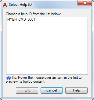

The next time the cursor hovers over the command on a toolbar or ribbon panel, the text is displayed in a tooltip.
When the command is added to a toolbar or ribbon panel, the extended tooltip content is displayed if extended tooltips are enabled and the cursor hovers over the command for the designated time interval.
