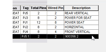

- The connector you added in Inventor is listed in the
Connector Selection dialog box. Select the row for the connector.

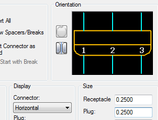

- On the connector display menu, click
Horizontal.
The display in the dialog box switches to horizontal.
- Click
Insert.
- Place the connector to the right of the power seat main switch.
