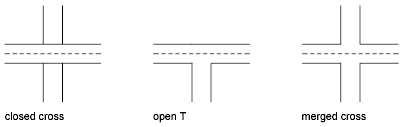

Create a Closed Cross Intersection
Multilines can intersect in a cross or a
T shape, and the crosses or
T shapes can be closed, open, or merged.
