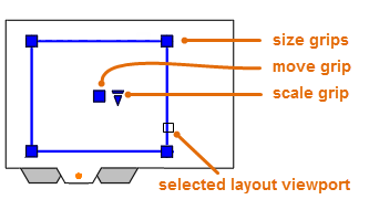

After you create a layout viewport, you can change its size and properties, and also scale and move it as needed.
Note: Because they are objects, you can also use editing commands such as COPY, MOVE, and ERASE on layout viewports.
