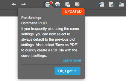

New features are highlighted in the product with a badge. Hover over the badge to see a brief description of what's changed. Select OK, I got it to remove the badge and tooltip.
If you prefer not to see the new features highlighted with the badge, clear Highlight New Features on the Help menu.

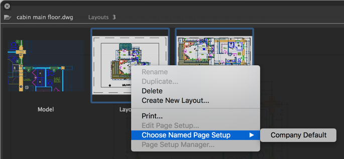

You can now apply a named page setup to multiple layouts from Quick View.

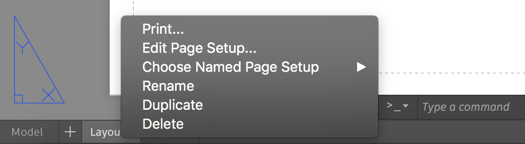

You can also apply a named page setup, edit a page setup, or print from the Layout tab context menu.
