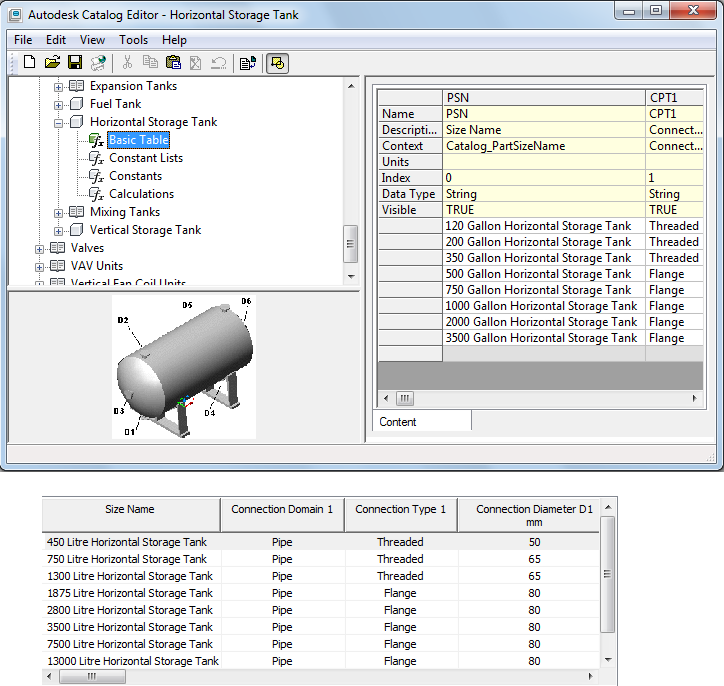

Viewing part sizes in Catalog Editor and in the part size table of the Add dialog box
Parameter attributes are defined by both fixed and extensible lists of values. Attribute values are specified by AutoCAD MEP toolset and cannot be changed; however, attribute values must be specified for custom data parameters that are added. Fixed data values cannot be edited. Extensible data values can be changed based on a list of predefined values, or extended to accommodate user-defined values. The following table shows the parameter attributes used to define size parameters.
Attribute | Type of Data | Examples |
Name | Extensible | D1, A2, user-defined |
Description | Extensible | Diameter D1, Angle A2, user-defined |
Context | Fixed | Connection Port Diameter, Path Angle |
Index | Fixed | 0, 1, 2, 3 |
Data Type | Fixed | Double, Integer, Boolean, String |
Visible | Fixed | True, False |
Units | Extensible | in, ft, mm, m, deg |
