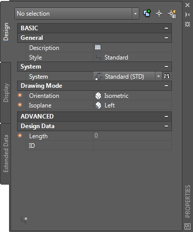

Note: On the Properties palette,
indicates a property is available only when you are adding schematic lines, not when you are modifying them.
- Expand Basic, and for Description, click
, enter a description for the schematic line, and click OK.
- For Style, select a schematic line style.
You can select from the styles in the current drawing.
- For System, select the system to which the schematic line belongs.
You can select from the systems in the current drawing.
Tip: You can create schematic line tools that reference styles and systems in content libraries (DWG files).
- For Orientation, select Isometric.
- For Isoplane, select the isoplane on which to start drawing: Left, Top, or Right.
- Expand Advanced, and for ID, select or enter an identification label.
The schematic line style that you select determines the list of available IDs. You can select an ID from the list or enter a different one.

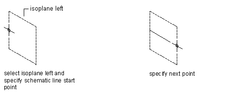

Drawing a schematic line on the left isoplane

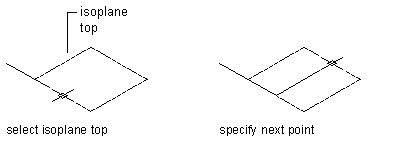

Drawing a schematic line on the top isometric plane

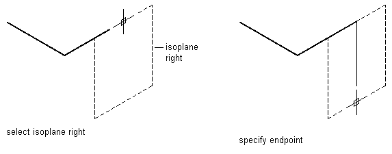

Drawing a schematic line on the right isometric plane
