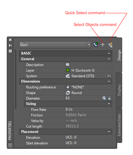

AutoCAD MEP toolset includes other ways to select objects in a drawing, such as:
Example on Duct Properties Palette
