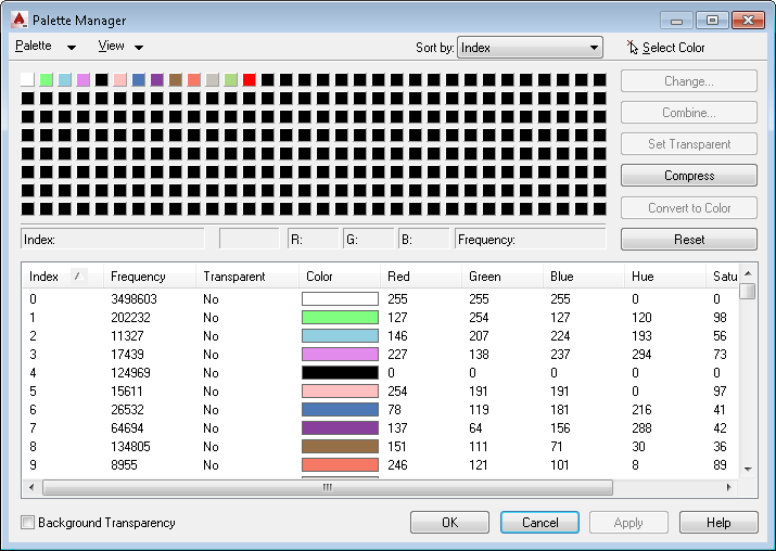

Click Raster Tools The Palette Manager dialog box displays the color palette for the map. |
| 4 |
Click Select Color, then click one of the contour lines in the drawing. The brown color (index 8) is highlighted in the Palette Manager, showing numeric values. |
| 5 |
Right-click the selected color square on the top row of the Palette Manager. Click Invert Selection. All colors except brown are selected. To isolate the contour lines, you can turn all the selected colors to white. |

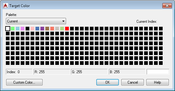

Click Combine. In the Target Color dialog box, click the white square, then click OK.
Note: The change in the Frequency column of the table: all colors except indices 0 and 8 now have a frequency of 0.
