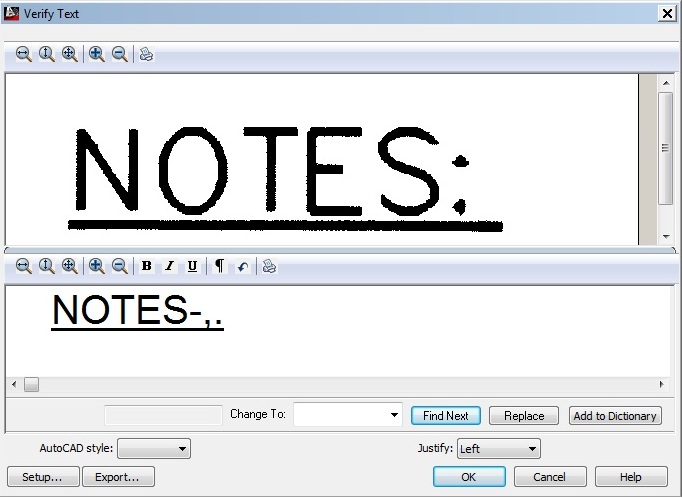

Use this dialog box in text recognition operations to examine the source text and control the format of the output text. The dialog is called Verify Text or Verify Table, depending on which option was selected.
Zooms in so the text fills the width of the view window and there is no horizontal scroll bar.
Zooms in so the text fills the height of the view window and there is no vertical scroll bar.
Zooms in so the text is completely contained in the corresponding pane at the greatest zoom possible.
Zooms in to expand the recognized raster text in the pane by a factor of 25%. The text may be zoomed in to a maximum factor of 300%.
Zooms out to shrink the recognized raster text in the pane by a factor of 25%. The raster may be zoomed out to a maximum factor of 25%.
Prints the data from the pane.
Zooms in so the text fills the height of the pane and there is no vertical scroll bar.
Zooms in so the text is completely contained in the pane at the greatest zoom possible.
Applies bold formatting to the selected text in the Editor pane.
Applies italic formatting to the selected text in the Editor pane.
Applies underline formatting to the selected text in the Editor pane.
Specifies the display of non-printing characters such as Tab and Space.
Reverses the last editing action.
Displays the unrecognized word.
Displays unrecognized characters or artifacts.
Specifies a replacement for the suspect word or rejected character from the drop-down list.
Moves to the next suspect word or rejected character.
Replaces the suspect word or rejected character with the selection in the Change To box.
Adds the suspect word or rejected character to the to the Recognition dictionary.
Specifies an AutoCAD style.
Specifies the conversion of the raster text as either AutoCAD Text or AutoCAD MText.
Specifies the text alignment as right, left, or center.
Displays the Text Recognition Setup dialog box.
Exports the text in the Edit pane for use in another application.
