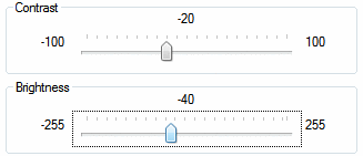

3 In the Histogram dialog box, click the Brightness/Contrast tab. Adjust the Brightness and Contrast sliders, noting the effects in the Preview. Choose a setting that improves the image visibility. Click Apply, then click Close.
